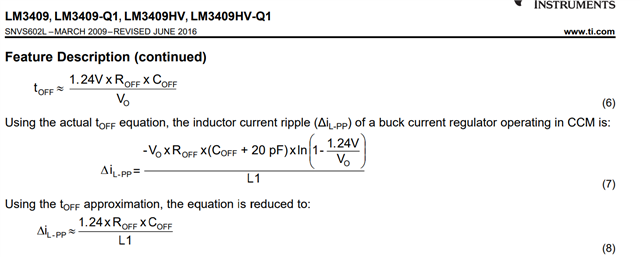

Hi Xiaoguang,
From my understanding as for the below picture, the current ripple can be reduced by adding the L and reducing the COFT?
