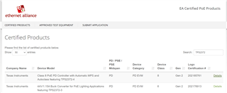

My customer is considering using the TPS2372-4RGWR for an IEEE 802.3bt application.
Could you please elaborate on what "IEEE 802.3bt (Draft)" means on the datasheet?

    Thanks for reaching out!
    IEEE 802.3bt is the newest widely used PoE standard so far. Please see below brief introduction.
    Since TPS2372 production year is closed to the 802.3bt published year so it refers some draft content. TPS2372 is IEEE 802.3bt compliant device and you can refer below designs certificated by ethernet alliance.
    Please let me know if you have any further questions or concerns.
