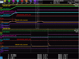

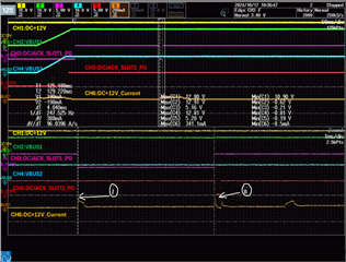

<Measurement waveform>
<Expanded figure of measured waveform>

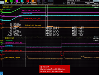

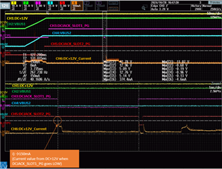

  • Hi Arush-san,
    Regarding your questions about the current values i) and ii), we have measured the current values.
    The current waveforms of the DC+12V line for i) and ii) as you indicated are shown below.
    Measurement conditions:
    1. RILM resistance of TPS259470A: changed from 3KΩ to 560Ω
    2. eFuse ILIM calculated value: 1.11A → 5.954A
    3. between ITIMER pin and GND: 0.1uF capacitor mounted
    Results:
    1. The FLT pin sometimes falls to the LOW level with no improvement.
    2. Even though there is no reverse current in the current waveform and the flowing current is lower than the overcurrent limit set by the ILIM pin, I cannot understand why the FLTb pin falls to the LOW level.
    3. This phenomenon does not occur when the VBUS line of the BQ25798 is disconnected from the OUT pin of the TPS259470A.
    Questions:
    1. are there any additional terminals that should be monitored?
    2. are there any other possible causes for the FLTb pin to drop after power input?
    We do not believe that overcurrent is the cause.
    i) DC+12V current value when DCJACK_SLOT1_PG (FLTb pin) goes LOW level for the first time ...150mA
    ii) DC+12V current value when DCJACK_SLOT2_PG (FLTb pin) goes LOW level for the first time ...154mA
    <Circuit diagram and waveform measurement position>
    Kagawa

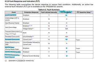

  • Hi Kagawa-san,
    Can we just probe itimer pin once to check if its voltage. This will us to confirm if there is any overcurrent event happening or not. Itimer will start to discharge when any overcurrent event happens.
    Can we also place a diode between the eFuse and the BQ device rail just for evaluation to check if this is preventing the issue. Diode will block the reverse current so we can be fully sure during the testing.
    This is the FLTb table and I don't think any other issue will cause FLTb to go low.
    Arush

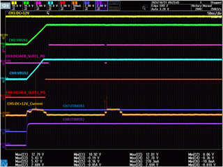

  • Hi Arush-san,
    ・I checked the waveform of the ITIMER pin, and the ITIMER pin voltage does not drop even when the FLTb pin is at a LOW level, so it is not considered to be in an overcurrent state.
    ・I understand that the FLTb pin is a function to determine the power supply status of the output side, but does the TPS259470A have a specification that causes a false detection of the FLTb status even if there is no problem with the output power supply status?
    ・Other than adding an external circuit, is it effective to add a standby time on the MCU(Mirco Controller Unit) side?
    If valid, please give your opinion on how much wait time should be set for the false trip time of the FLTb state.
    1. the waveform when the ITIMER pin is probed is shown below.
    Enlarged measurement waveform:
    <Measurement position of ITIMER1 and ITIMER2>
    Kagawa
  • Hi Kagawa-san,
    Yes, it looks like this is not due to overcurrent. Most likely cause will be reverse current. The reverse current blocking starts with only -30mV threshold so it is difficult to check on waveforms.
    Did you try this?
    Can you increase the BQ25798 device input cap and check if this resolves this issue
    Coming back to your questions
    This will depend on the application. I think you are seeing around 2-3ms of false FLTb low so keeping standby time to 5ms or something similar should be good. Keep it less than 110ms (retry time of device).
