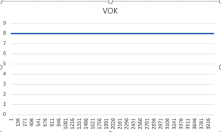

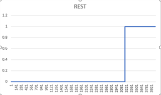

    According to the Golden Learning process, after the charging is completed, it cannot changed to 0x05 after resting for 2 hours.
    In the log file attached, VOK has not cleared from the previous discharge indicating a proper OCV measurement has been taken during the relax in between discharge and charge:
    It also seems like the gauge does not enter rest, where the cell is relaxed enough to take a proper OCV measurement, during this relax period as well.
    Please ensure there is no current and an ample amount of time in relax between the discharge and charge for a proper OCV measurement to be taken.
    Anthony
  • 5504-4.4AH 241031C.logHello,
    I enabled the power gauge (GAUGE_EN) after the system stabilized, and then started charging. The attached file is the latest log charging and discharging. After the effective termination of charging, it did not change to 0x05, and it did not change after the stabilization was. What other data do you need for analysis?
    Since we cannot see the data prior to the charge, please confirm whether the necessary bits have moved properly in the relax period before the charge.
    If they do not, then this could be causing the issue since these values are relied on for the Qmax update.
    Anthony
