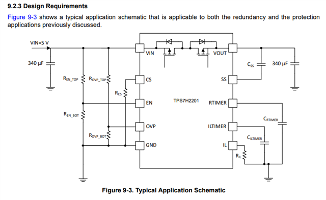

Firstly, I tried to use the proposed design given in the datasheet and made necessary calculations in order to choose the resistor and capacitor values.
My preferred values are given below:
Ren_top: 100K, Ren_bot: 16K6,
Rovp_top: 100K, Rovp_bot: 12K95,
Rcs: 41K5
Css: 150nF
Crtimer: 220nF
Ciltimer: 2n2F
Ril: 6K81
There is no input and output capacitors.
When I tried to simulate the proposed design circuit by using the pspice simulation model, I could see all expected results according to the load change.
For example, the power switch is in current limit operation with a specified timer and turned off, then its retry mode is activated and those operations works continuously during a heavy load condition.
When I built the same circuit on a PCB, I could not see the expected results. During the heavy load or short circuit condition, the power switch is in current limit operation and its retry mode is activated in only one time.

    Is RTIMER connected to ground instead of a capacitor which would cause it to need power cycling through the EN pin?
    Do you have a schematic so we can verify that all resistors and capacitors are in their correct position?

    In the previous post, I explained that I used the typical application circuit proposed in the datasheet by TI and chose the neccessary resistor and capacitor values according to it. You can check the below circuit given in the page 33 of the datasheet.

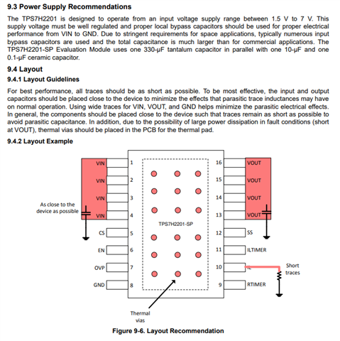

    Would you be able to share your layout and the production/PCB schematic(s)?
    Elizabeth
  • Sorry, I cannot share my PCB design file because of privacy rules.
    Can you say the reason of this request? What is your doubt about my PCB design?
    Let me clarify that if there was a PCB design fault, we could see a malfunction on some features of this IC such as disabling device, protection failure, etc.
    When I tested the proposed application circuit on my PCB design, I could see that overcurrent and overvoltage protection, current limit and retry, enabling/disabling the device features worked constantly. However, it is seen that current limit and retry feature only works for once (not continously) and then the power switch is disabled permanently. I think PCB design fault cannot cause such a result.
    In addition, you can be sure that I followed the rules provided with the datasheet given below except that there is no input & output capacitors in my design. I'm using a proper power supply for 5V VIN and even if I added these capacitors, I couldn't see any change on this problem.
    Please give me a consistent opinion that will cause to occur such a problem about current limit and retry feature.

    You can check my preferred parameters (C_ILTIMER: 2.2nF & C_RTIMER: 220nF) with the equation given below:
    I think my capacitor values meet the requirements of the above equation theoretically. If I'm wrong, let me know please.
