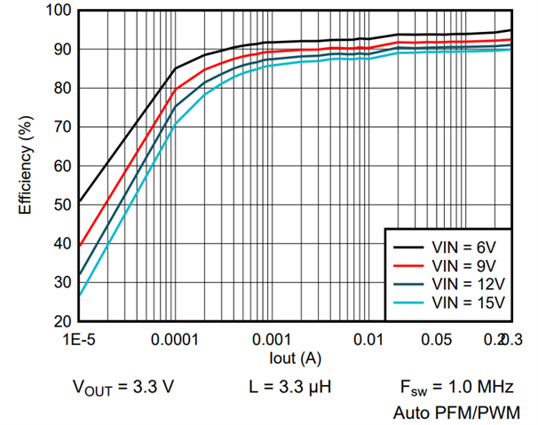

What is the Iq of the TPS629203 in power-save mode?
TI-CSC
HI,
We don't have such spec in datasheet. But you can refer to below efficiency curves in Iout=10uA which can equal to no load.
Colin
Hello Colin,
Good day.
What is the power consumption of the TPS629203 consumption in low-power mode?
