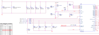

Customer used TPS546D24A and find out the timing of Vo startup after enable is different in different boards.
The test was done with two top markings:
TPS546D24A TI 02I AV9V E4

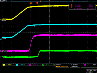

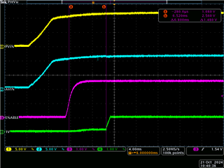

TPS546D24A TI 31I AV8E E4
The top marking with 31I AV8E E4 has longer delay time about 3ms. Customer swap the chips and the symptom followed the chip.

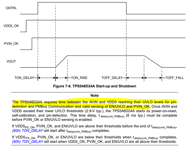

Do you have any ideas why this might happened?
