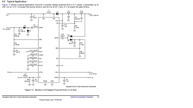

How to adjust the voltage output value of VCOM independently?

Ratio of R7 and R8 will set the VCOM output voltage.
