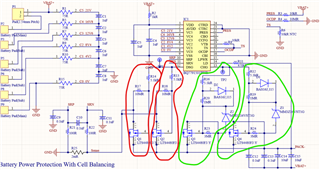

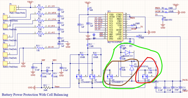

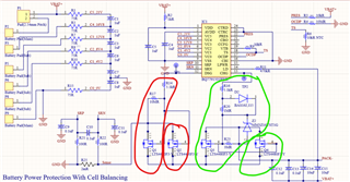

I would like to ask about circuit for MOSFET at charging side and discharging side. Sense resistor(2mR) is implemented to ensure max 30A Load. Due to the Heat dissipation issue. Hence, I have decided to put 2 mosfet, but I am not so sure which circuit is more reliable? Circuit 1 or Circuit 2. Please provide suggestion and explanation. Thanks in advanced.
Circuit 1
Remarks: Duplicate the whole circuit & parallel for charging and discharging side respectively.
Circuit 2
Remarks: Only parallel the MOSFET.
