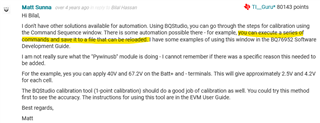

    Thank you for the response. After going through the links you've provided, I came up with a follow up question about the cell voltage gain calibration:
    According to one of the responses in the post BQ76952: Sample calibration code example, it seems that the 'Command Sequence' tab of the BQSTUDIO need to be used instead of the 'Calibration' tab to perform the cell voltage gain calibration . Is this correct?
    Is the best way to perform the cell voltage gain calibration saving the sequence of the commands based on what's described in the 'BQ769x2 Calibration and OTP Programming Guide' as a file and reusing the sequence all throughout the cells in use?
    Kyungjae Lee
  • Hello Kyungjae,
    The calibration tab of bqStudio is good if you want to perform 1-point calibration. Which for some customers, it is acceptable.
    For best accuracy, you would want to perform 2-point calibration, which would mean that you'd have to manually find the gain/offset using two voltage points (Using the Calibration application note as reference). This can be done with bqStudio or the MCU, whichever you prefer.
    Command sequence is not really necessary, unless you want to automate some of the steps shown in Section 2.2 Cell Voltage Gain Calibration to gather the data.
