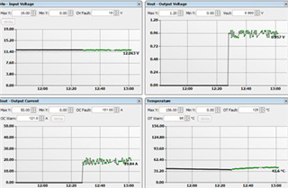

We are testing the  TPS53647EVM-710 board integrated into one of our development boards , powering ASIC chip.
As long as the remote sense lines are set  on the TPS53647EVM-710 board , everything is OK , we get the 0.9V/~40A  output into  our board .
But, once using the remote sense lines near the load (ASIC) ,TPS53647EVM-710 output seem to be noisy/unstable :
P.S - we are using rather short(8cm) thick cables to connect the TPS53647EVM-710 to our test board.
Can you please advise what could be the issue here?
Thanks!
  • Hi Amir,
    If you probe the Vout using a differential probe on an output capacitor do you see the noise being reported? It looks like there is a lot of noise near when the sense lines are connected. Some causes for noise could be system stability or layout.
    Ryan
