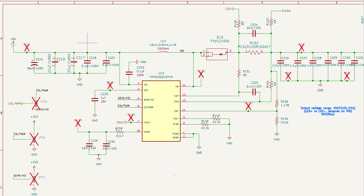

We designed a maximum 63V LED driver circuit that can be adjusted in the 0-2A range using TPS923652 LED driver (We used 20 of this circuit and will adjust 20 different LEDs). We made the circuit the same as TPS923655DRRRREVM. As I shared in the link below, our hardware friend asked you questions. (We have been interested in this project for 2 weeks). How can you support us technically? Our customer is waiting for this product. We tried everything such as adjusting the coil, shunt resistor and voltage divider resistors connected to the OVP pin, we use STEP mode and we are very familiar with the working principle. At first, we made adjustments according to 100mA and it worked stably, then we could not adjust it at all for the maximum current of 700mA. As the first step, we want you to help us with the values ​​of the 0-700mA 0-36V circuit passives and in which mode we will use them.
