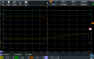

We are using TPS1HB08AQPWPRQ1 in the design. What is the reaction time to shutting down the HSS once current limit is reached?
Currently set value in design is 12A. I am getting current limit triggered ~12.4 A after 3.4ms if it is overcurrent condition.
If SC to GND occurs, output shutdown is triggered within ~20us
