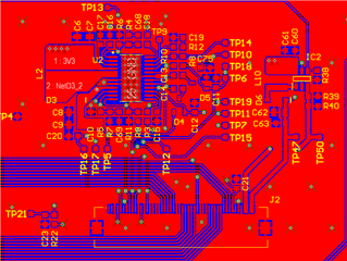

I realize that the thermal pad was not connected. Can this generate EMI or is it only used for power dissipation ?
  • Hi Yusuf,
    What package that you are using? It is recommended to connect the thermal pad for dissipation.
    BR
    Patrick
    I am using the HTSSOP-24 package. There was an error in the footprint of the component.

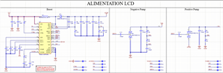

    This is my board
    If there is something wrong, please tell me.
