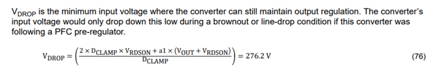

    Q3.
    Equation (77) may need to be modified in the following two ways. Could you please confirm the following?
    A. About POUT
    In equation (77), POUT (output power) is used to calculate the input capacitor capacitance, but in reality, the efficiency must be considered. Therefore, it is correct to use POUT / η. This allows the calculation to be based on the actual input power, including the system loss.
    >You are correct that this is a better estimate to input power by dividing POUT  by estimated efficiency η
    B. About VIN
    In equation (77), VIN (input voltage) is used, but in reality, it is appropriate to use the minimum input voltage VINMIN. This is because the capacitance of the capacitor is most important when the input voltage is at its lowest.
    > The design used a slightly different approach in calculating the minimum input voltage (VDROP) in equation 76 that was used in 77.
    If we calculate based on this correction, CIN will probably be 355uF or more.
    >If use a POUT / η you are correct that the bulk capacitor will increase.
    >I will notify the applications team so they can select the bulk capacitor based on estimated input power.  I do believe that this is a better estimate.

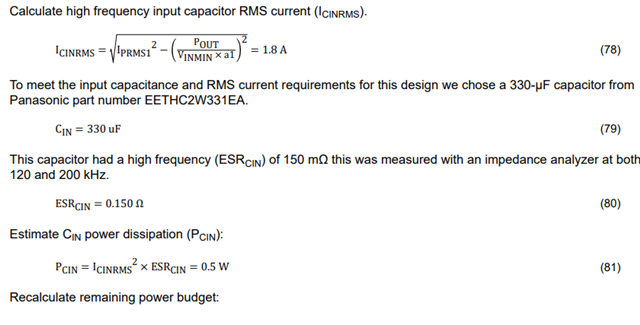

    Q4.
    Equation (78) may need to be corrected in the following two points. Could you confirm the following?
    >O.K.
    C. Regarding a1
    Equation (78) uses a1, but efficiency (η) should actually be used here. If the calculation is made without considering efficiency, the actual power loss cannot be correctly reflected, so a1 is incorrect and η is correct.
    >When it comes to estimating RMS current it is better to over estimate.
    >In this case not including efficiency and the reflected DC current is O.K.
    >You are correct that adding efficiency is a better estimating.  However, this is still estimated.  The efficiency could be higher and lower based on the components that you choose.
    D. ICINRMS (Input Capacitor RMS Current)
    When calculated using the corrected formula, it is considered reasonable that ICINRMS = 1.8A.
    > This is what the application note calculated for RMS current.
    Furthermore, regarding the loss PCIN of the input capacitor, the loss is generally calculated as follows:
    PCIN =ESR×I^2 CINRMS
    > This is actually the equation that is used in the application note.
    Here, ESR is the equivalent series resistance of the input capacitor. If ICINRMS is 1.8A and ESR is an appropriate value, PCIN = 0.5W. Therefore, after correcting equation (78), ICINRMS becomes 1.8A, and based on that, the calculation result is thought to be 0.5W for the capacitor loss.
    > This is true based on the application note excerpt that is presented above.

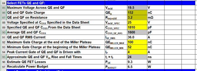

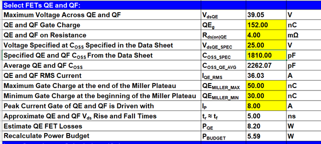

    Q7.
    First, regarding QgQE in equation (70), does this refer to the same thing as QEg in equation (59)? Next, regarding VgQE, it does not seem to be clearly defined in the application note. I would like to know at what V the loss calculation result of 14.4W was obtained.
    > These should be the same gate charge.
    Equation 70 calculates 9.3 W and not 14.4W.  I think this matches the excel design tool as well.  The V is the Vgate that come from the UCC28950.  You can enter this in the excel tool it is variable Vg. The power dissipation calculated by the excel tool is also  9.3 W.
