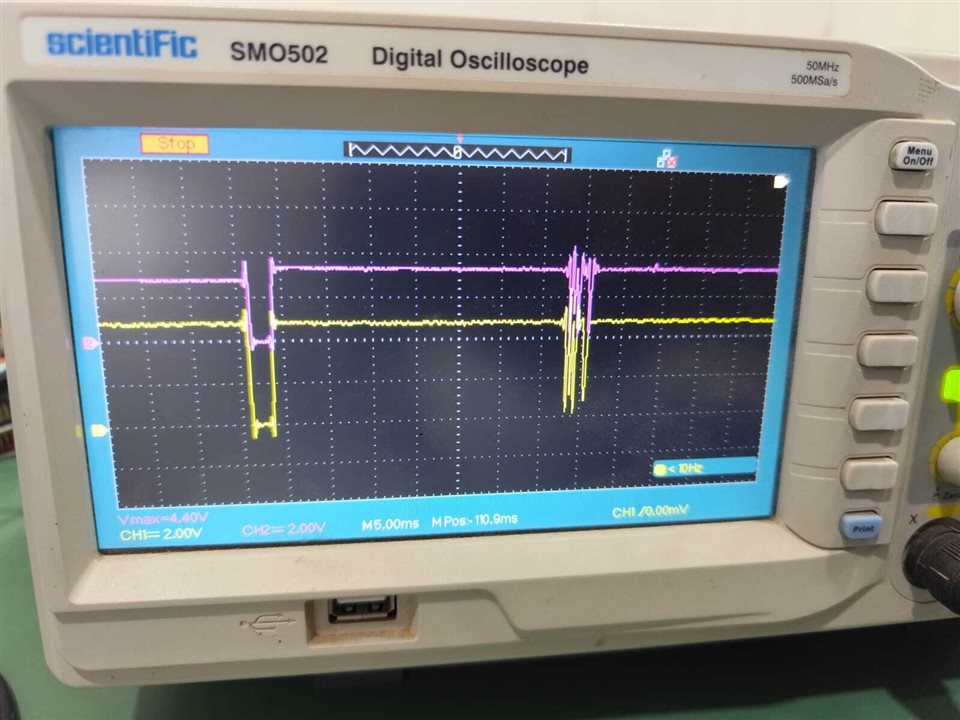

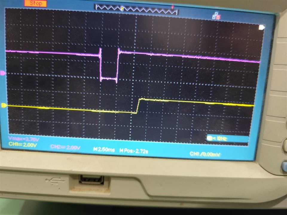

figure 1 - logic level shifter
figure 2 - wake up signal (DSO)
figure 3 - wake up signal (logic analyzer)
figure 4 - auto addressing (DSO, purple-MCU Tx, yellow- bq79616 Rx)
figure 5 - auto addressing (logic analyzer)
The above mentioned observations have been attached for your reference.

  • Hi Benjamin,
    We tried out the code with two wake up pings and also increased the timing between the wake ping and start of communication upto 30ms.
    Even with these changes the AFE isn't sending the acknowledgement to the MCU.
    Have attached the images for reference.
    What might be the issue. Waiting for your valuable response on the same.
    Ibrahim
