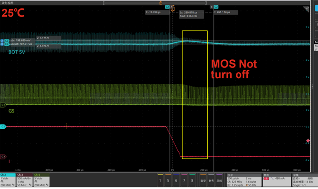

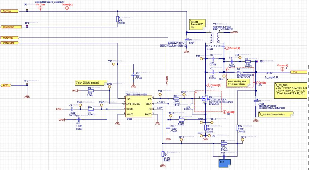

  • Hello Niklas
    Thanks for your reply. Now, we have only used this chip in the SEPIC circuit, so the test results are only around this circuit.
    You can refer to the circuit in the figure.
    You can see that the peak value of the 5V output at room temperature(5.175V) is higher than that at 105℃(5.15V), but the protection is not triggered to shut down the MOS.

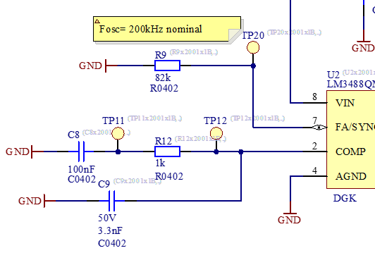

  • Hi Hui,
    Thanks for explaining the test setup.
    So if I understand correctly, the main issue is that the device stops switching after an overshoot at high temperature, while it keeps switching under room temperature conditions?
    This might be avoided by adjusting the compensation. If the loop compensation is designed faster, it may compensate the load step with a smaller overshoot at Vout, hence continuing to switch stable under all temperature conditions.
    I can also suggest values for the compensation. For this I would need VIN, VOUT, max load and inductance of the application, and it would also be helpful to attach the schematic in higher resolution, so it is easier to read the component values.
    Niklas
  • Hello Niklas
    Yes, but you can see that with the same circuit parameters, at room temperature, Vout overshoots to 5.17V and does not stop switching, but at high temperature, Vout overshoots to 5.15V and stops switching.
    I tried uploading a clearer picture but it seems to be compressed,So let me tell you the relevant parameters first:
    VIN=6v~24v(Tested with 13,5V), VOUT=4.92~5.06V, max load=0.9A and inductanceL1=L2=15uH
    Best regards!
    Hui

  • Hello Hui,
    Thanks for providing all the details.
    I recalculated the compensation and reviewed the design.
    The compensation values are already well designed. Power stage looks okay as well.
    The only comment I can give is that there is only one 100uF aluminium cap on the output side.
    To reduce noise on the output, we recommend to add additional low ESR ceramic caps close to the output diode to reduce switching ripple noise.
    However, I cannot guarantee this will avoid the overshoot issue you face at high temperature.
    As this behavior is still within the device specification, it is possible to can occur only one some units while others might perform fine, so I though by improving the full design to reduce overshoots, the problem will be solved for all devices.
    If the application is already well design, this switching stop may not be avoided at high temperature if load transients with this slew rate are expected.
    Niklas
