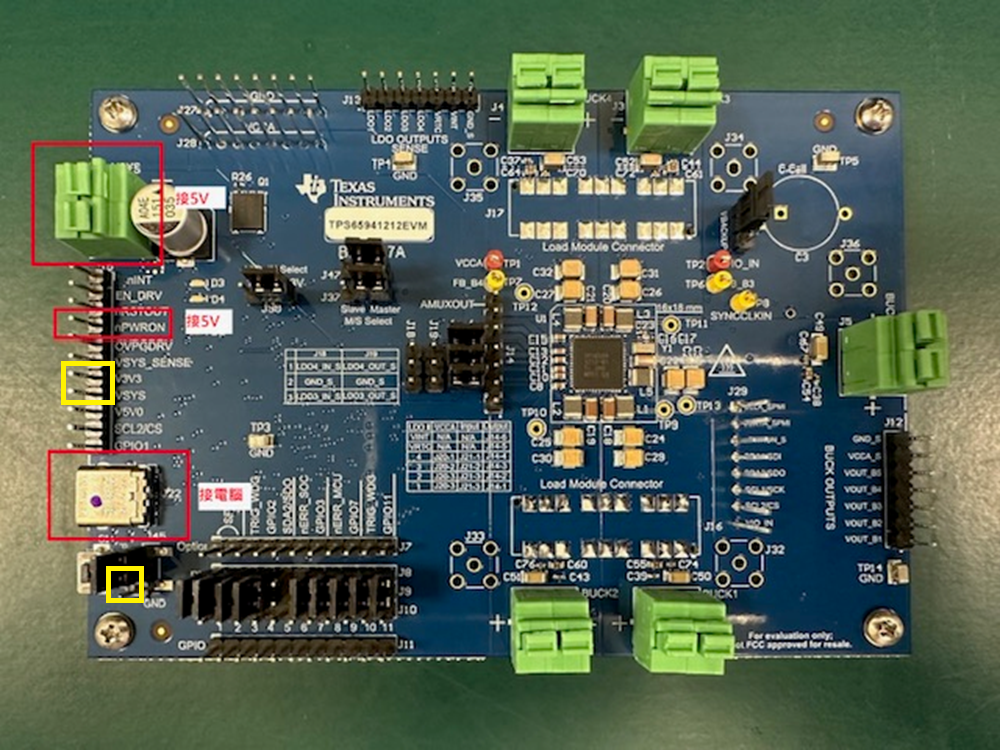

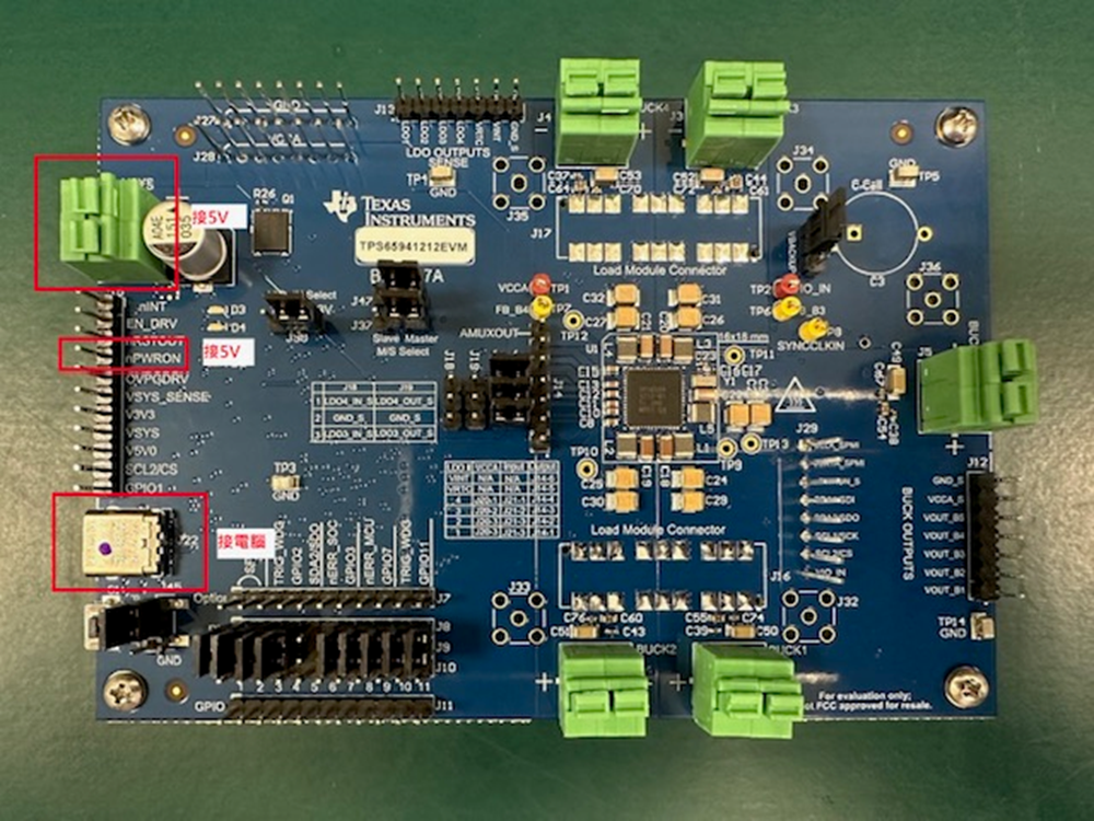

we bought a evb, try to link the EVB & NB, but fail
did you have any suggestion?

    The TPS65941212EVM is part of a two PMIC solution. To connect the GUI to the EVM please have the jumper settings on on J15 & J45, then connect from the PC to the EVM with a USB-C cable on J22. These are shown in yellow.
    J15: jumper on VSYS to V3V3.
    J45: jumper from middle pin to ground.

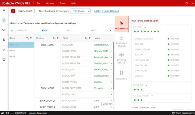

    The PMIC and board are being powered off of the USB. Make sure the GUI is set for TPS6594x & I2C address: 0x48
