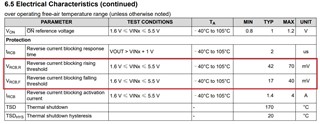

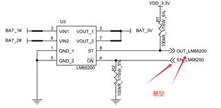

When we add input voltage on both VIN1 and VIN2 of LM66200, the output voltage is only 0.5V. But when removing any of the VIN, the output voltage is normal. Also, if there is no load at the output, the output voltage is normal.
The schematic is as below:
Can you help analyze the cause of this problem?
