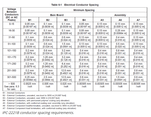

Team,
Could you please explain more about the layout guide from the datasheet "Spacing consistent with safety standards like IEC60950 must be observed between the 48-V input voltage rails " ?
1. What is the spacing requirement exactly? And for 60V ?
2. Why it seems that on the TPS2376HEVM PCB no IEC60950 clearance has been respected ?
Thank you.
