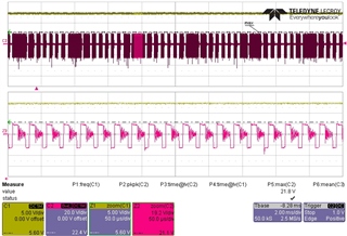

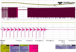

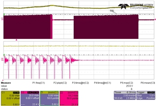

    I would say for certain that the output OVP is not the cause. Screenshot are attached to support my standing.
    The first three screenshots are taken for the original configuration of the flyback converter; at input voltages of 200VAC, 265VAC and 85V respectively
    The second two screenshots are taken for the original configuration of the flyback converter but added a 240k resistor in parallel to R16 (the lower part of OVP attenuator from Vbias winding to OVP input) i.e. a 15% increase in OVP threshold; at input voltages of 200VAC and 265VAC respectively
    The third three screenshots are taken for the original configuration of the flyback converter having R13 removed (the upper part of OVP attenuator), thus leaving the OVP input of UCC28600 fully non-driven; at input voltages of 200VAC, 265VAC and 85V respectively
    I only see steady output voltage at 85VAC input for all three configurations, 200VAC hickups in all three configurations and 265VAC hickups only when OVP input is not driven (but still loaded to ground)
    Original configuration @ 200VAC (hickup)
    Original configuration @ 265VAC(smooth)
    Original configuration @ 85VAC (smooth)
    load OVP threshold increased 15% @ 200VAC (hickup)
    load OVP threshold increased 15% @ 265VAC (smooth)
    OVP disabled @ 200V (hickup)
    OVP disabled @ 265V (hickup)
    OVP disabled @ 85V (smooth)
    Best regards
    Flemming

    Sorry for not including the description of traces:
    Yellow trace is the primary output (the one that has the feedback connection) of +15V QSAUX in the original attached schematic diagram.
    Red trace is the unfiltered (BW 500MHz) output of the winding feeding UCC28600 OVP input and rectifier for VDD, T1 pin 6
    Screenshot upper half is included to indicate whether output voltage is kept smooth, hence has a rather slow scanrate.
    lower half is a zoom allowing judging of overshoot and the like for the OVP input to UCC28600
    Included in the screenshots are also an automatic measurement, taken from the slow scan window, indicating the maximum voltage of Channel 2 (the red trace)
    What I see is that no matter the attenuation from the red trace to the UCC28600 OVP input, the instability occurs whenever the peak voltage measured by the red trace is in excess of roughly 23V.
    This is the reason that I suspect that an undocumented additional OVP function exist that is based on the VDD supply voltage level.
    I think I have read in the datasheet that VDD exceeding 21V nominally would trigger some sort of shunt regulator within the UCC28600, but I saw no warning that activating this regulator would upset the regulation of the device.
    This voltage level is still far below the maximum rating of 32V for the VDD.
    The fact that introducing additional diode drop from three series connected diodes to the D8 eliminates the fluctuation of the regulated output voltage, further convinces me that a VDD based secondary OVP function exist.
    best regards
    Flemming

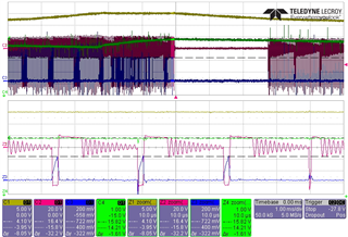

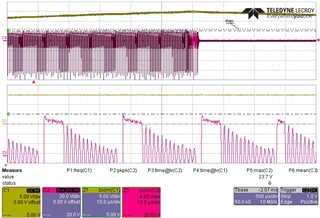

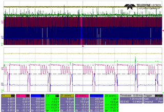

  • Hi Mike,
    I've found the time to do some measurements
    In the following screenshots the instability of the regulated output (yellow trace) is visible in the main timebase and, when instability occurs the zoomed timebase will show the last four cycles before collaps.
    When no instability occurs the zoomed timebase will be at a random pick of time.
    Trace colours:
    Yellow: regulated +15V QSAUX
    Red: voltage from Aux winding T1 pin6 (also supplying VDD)
    Blue: Current sense input UCC28600 pin3
    Green: VDD UCC28600 pin6
    OVP has been reinstated althought threshold has been increased by 18% (R13 changed to 330k)
    Still the instability occurs at 200VAC and 265VAC input.
    load OVP threshold increased 19% @ 200VAC (hickup)
    I
    load OVP threshold increased 19% @ 265VAC (hickup)
    load OVP threshold increased 19% @ 85VAC (smooth)
    What catches my eye is the slow increase of VDD until collaps occurs in the 200VAC and 265VAC screen shots, when running smooth at 85VAC the VDD stabilizes just  slightly lower than the maximum detected at 200VAC and 265VAC.
    Adding another load at the regulated +15V QSAUX output valued at 22 Ohms will also change into stable running at all three tested input voltages.
    load OVP threshold increased 19% + output load increased 680mA@ 200VAC (smooth)
    load OVP threshold increased 19% + output load increased 680mA@ 265VAC (smooth)
    load OVP threshold increased 19% + output load increased 680mA@ 85VAC (smooth)
    Unfortunately the increase of idle power consumption is not a viable way forward as it will indeed subtract from the power efficiency of the appliance and from the maximum available output power.
    Best regards
    Flemming

  • Hi Mike
    In the zoomed part the identification of traces is easier than in the upper slow scan part:
    uppermost is yellow, +15QSAUX regulated output
    next is green VDD at UCC28600 pin6
    next, more square with idle ringing is red, voltage from Aux winding T1 pin6 (also supplying VDD)
    Lower is blue, Current sense input UCC28600 pin3
