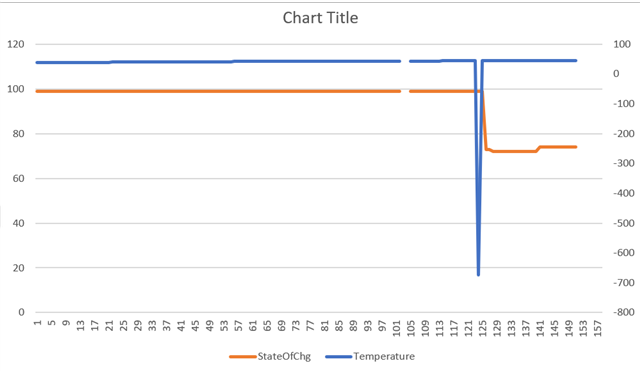

At present, our company uses BQ27426 as the gas gauge for our product. We use a 4.4V battery with a chem ID of 3412, and we set the cut-off voltage of the battery to 3.5V. When the battery level is displayed as 30%~40% and the video is played at full load, the battery current output is about 5A, and the battery voltage drops from 3.8V to 3.5V. After playing the video for a period of time, the battery level jumped directly from 30% to 40% to 0. At this time, using EV2300 to read the information, it was found that the power meter entered SOC1 and SOCF. What is the reason for this and what methods can be used to solve this problem?

    Would you be able to send over a bqStudio log file with the SoC drop behavior, as well as a .gg file for your configuration?
    Robert.
  • The phenomenon of the battery meter jumping to 0 has been resolved, but it has been found that there is a jump in battery level when playing videos, such as from 99% to 74%

    Sample,DateTime,ElapsedTime,Control,CtrlStatus,Temperature,Voltage,Flags,NomAvailCap,FullAvailCap,RemCap,FullChgCap,AvgCurrent,Qmax,AvgPower,Present DOD,StateOfChg,Int Temp,SOH,OCVCurrent,OCVVoltage,SimultCurrent,RemCap UnFlt,RemCap Flt,FullChgCap UnFlt,FullChgCap Flt,True StateOfChg,DOD0,DOD at EOC,True RemCap,Passed Charge,Qstart,DOD_Final,LogRowTime(ms),LogStatus
    1,2024-10-30 15:38:30,4.001,0x0000,0x008C,37.65,4223,0x00C9,5920,5920,3765,3804,-1017,6290,-4295,68,99,37.65,90,-1465,3773,-1022,3804,3804,3804,3804,100,7664,416,3937,-2916,2783,10323,916,SUCCESS
    2,2024-10-30 15:38:34,8.001,0x0007,0x008C,37.75,4160,0x00C9,5920,5920,3765,3804,-1190,6290,-4950,74,99,37.75,90,-1465,3773,-1493,3804,3804,3804,3804,100,7664,416,3935,-2914,2783,10323,994,SUCCESS

    103,2024-10-30 15:45:18,412.040,,,,,,,,,,,,,,,,,,,,,,,,,,,,,,,1035,ERROR : Please check D:\Users\user\Desktop\111.log.err
    104,2024-10-30 15:45:22,416.040,,,,,,,,,,,,,,,,,,,,,,,,,,,,,,,1029,ERROR : Please check D:\Users\user\Desktop\111.log.err
    105,2024-10-30 15:45:34,428.034,0x0202,0x008C,43.35,4068,0x00C9,5907,5920,3757,3795,-1637,6290,-6659,451,99,43.35,90,-1845,4087,-1631,3782,3781,3795,3795,100,0,416,3781,174,-160,10302,872,SUCCESS
    106,2024-10-30 15:45:36,430.252,0x0202,0x008C,43.25,4070,0x00C9,5905,5920,3757,3795,-1723,6290,-7007,456,99,43.35,90,-1845,4087,-1646,3780,3780,3795,3795,100,0,416,3780,175,-160,10302,966,SUCCESS

    124,2024-10-30 15:46:46,500.049,0x008C,0x008C,-672.85,4006,0x00D9,5866,5920,3741,3795,-2076,6290,-8316,557,99,44.15,90,-1845,4087,-2037,3741,3741,3795,3795,99,0,416,3741,214,-160,10302,950,SUCCESS
    125,2024-10-30 15:46:50,504.049,0x000C,0x000C,44.15,4001,0x00C9,5866,5920,3741,3795,-2053,6290,-8214,557,99,44.25,90,-1845,4007,-2044,3741,3741,3795,3795,99,3232,416,3741,0,-160,10302,903,SUCCESS
    126,2024-10-30 15:46:54,508.050,0x008C,0x008C,44.25,4003,0x01C9,4817,5918,2850,3951,-2049,6290,-8204,3285,73,44.25,90,-2046,4004,-2038,2849,2849,3951,3951,73,3280,416,2849,2,1100,10706,980,SUCCESS

  • The above is our gg file and the log when an exception occurs
    Thank you for providing the log file. It looks like this SoC jump is being caused by the severe change in temperature, please see the image below. This change in temperature is not realistic, and is causing the gauge to perform another simulation to estimate the SoC. Since the impedance of the battery increases as the temperature decreases, this causes a significant IR drop and thus a decrease in estimated capacity.
    Robert.

    98,2024-10-30 22:21:57,393.032,0x0000,0x208C,48.25,3568,0x01C9,3053,5882,32259,3636,-2280,6290,-8135,7881,26,48.25,90,-1291,3803,-2274,2183,916,5013,3636,44,7188,512,2183,267,2563,13570,1000,SUCCESS
    99,2024-10-30 22:22:01,397.064,0x0000,0x208C,48.25,3572,0x01C9,3050,5882,915,3636,-2285,6290,-8162,7889,26,48.25,2818,-1291,3803,-2292,2181,915,5013,3636,44,7188,512,2181,269,2563,13570,1077,SUCCESS
    100,2024-10-30 22:22:05,401.097,0x0000,0x208C,48.35,3571,0x01C9,3048,5882,914,3636,-2295,6290,-8195,7894,26,48.35,90,-1291,3803,-2283,2178,914,5013,3636,44,7188,512,2178,272,2563,28544,1000,SUCCESS
    101,2024-10-30 22:22:09,405.063,0x0000,0x208C,48.35,3571,0x01C9,3045,5882,913,3636,-2344,6290,-8370,7902,26,48.35,90,-1291,3803,-2470,2176,912,5013,3636,44,7188,512,2176,274,2563,13570,971,SUCCESS
    102,2024-10-30 22:22:13,409.095,0x0000,0x208C,48.35,3572,0x01C9,3043,5882,912,3636,-2285,6290,-8162,7907,26,48.35,90,-1291,3803,-2283,2173,911,5013,3636,44,7188,512,2173,277,2563,13570,984,SUCCESS
    103,2024-10-30 22:22:17,413.081,0x0000,0x208C,48.35,3566,0x01C9,3040,5882,911,3636,-2285,6290,-8148,7915,26,48.45,90,-1291,3803,-2289,2171,910,5013,3636,44,7188,512,2171,279,2563,13570,1076,SUCCESS
    104,2024-10-30 22:22:21,417.081,0x0000,0x208C,48.45,3518,0x01C9,3038,5882,910,3636,-2238,6290,-7873,7920,25,48.45,90,-1291,3803,-1695,2168,909,5013,3636,44,7188,512,2168,282,2563,13570,1000,SUCCESS
    105,2024-10-30 22:22:25,421.079,0x0000,0x208C,48.35,3649,0x01C9,3036,5882,909,3636,-1686,6290,-6152,7925,25,48.35,90,-1291,3803,-1667,2166,909,5013,3636,44,7188,512,2166,284,2563,13570,1016,SUCCESS
    106,2024-10-30 22:22:29,425.095,0x0000,0x208C,48.25,3655,0x8501,3034,5882,908,14584,-1649,6290,-6027,7930,25,48.25,90,-1291,3803,-1690,2165,908,5013,3636,44,7188,512,2165,285,2563,13570,1017,SUCCESS
    107,2024-10-30 22:22:33,429.096,0x0000,0x208C,48.15,3651,0x01C9,3032,5882,907,3636,-2071,6290,-8680,7938,25,48.15,1027,-1291,3803,-2446,2162,907,5013,3636,44,7188,512,2162,288,2563,13570,1029,SUCCESS
    108,2024-10-30 22:22:37,433.049,0x0000,0x208C,48.25,3583,0x01C9,3029,5882,906,3636,-2206,6290,-7904,7943,25,48.25,90,-1291,3803,-2201,2160,906,5013,3636,44,7188,512,2160,290,2563,13570,1016,SUCCESS
    109,2024-10-30 22:22:41,437.049,0x0000,0x208C,48.25,3578,0x01C9,3017,5872,905,3636,-2190,6290,-7836,7949,25,48.25,90,-1291,3803,-2191,1971,905,4827,3636,41,7188,512,1971,293,2563,13085,1050,SUCCESS
    110,2024-10-30 22:22:45,441.066,0x0000,0x208C,48.25,3560,0x01CF,1203,5871,1,4668,-2319,6290,-8256,12674,1,48.25,90,-1291,3803,,0,0,4668,4668,0,7188,512,-2,2107,2563,4458,1031,ERROR : Please check D:\Users\user\Desktop\333.log.err
    111,2024-10-30 22:22:49,445.081,0x0000,0x208C,48.35,3558,0x01CF,1203,5871,1,4668,-2231,6290,-7938,12681,1,48.35,90,-1291,3803,-2593,0,0,4668,4668,0,7188,512,-5,2110,2563,4458,999,SUCCESS
    112,2024-10-30 22:22:53,449.083,0x0000,0x208C,48.35,3634,0x01CF,1203,5871,1,4668,-1752,6290,-6367,12687,1,48.25,90,-1291,3803,-1751,0,0,4668,4668,0,7188,512,-7,2112,2563,4458,998,SUCCESS
    113,2024-10-30 22:22:57,453.067,0x0000,0x208C,48.25,3639,0x01CF,1203,5871,1,4668,-1742,6290,-6339,12692,1,48.25,90,-1291,3803,-1721,0,0,4668,4668,0,7188,512,-9,2114,2563,4458,981,SUCCESS
    114,2024-10-30 22:23:01,457.066,0x0000,0x208C,48.15,3640,0x01CF,65426,5871,1,4668,-1748,6290,-6363,12697,1,48.15,90,-1291,3803,-1715,0,0,4668,4668,0,7188,512,-11,2116,2563,4458,985,SUCCESS
    115,2024-10-30 22:23:05,461.067,0x0000,0x208C,48.15,3591,0x01CF,1203,5871,1,4668,-1867,6290,-6704,12705,1,48.05,90,-1291,3803,-1848,0,0,4668,4668,0,7188,512,-13,2118,2563,4458,1014,SUCCESS
    116,2024-10-30 22:23:09,465.099,0x0000,0x208C,48.05,3643,0x01CF,1203,5871,1,4668,-1733,6290,-6401,12710,1,48.05,90,-1291,3803,-1758,0,0,4668,4668,0,7188,512,-15,2120,2563,4458,984,SUCCESS
    117,2024-10-30 22:23:13,469.066,0x0000,0x208C,47.95,3615,0x01CF,1203,5871,1,4668,-1762,6290,-6370,12713,1,47.95,90,-1291,3803,-1849,0,0,4668,4668,0,7188,512,-17,2122,2563,4458,1000,SUCCESS
    118,2024-10-30 22:23:17,473.097,0x0000,0x208C,47.95,3619,0x01CF,1203,5871,1,4668,-1778,6290,-6435,12721,1,47.95,90,-1291,3803,-1713,0,0,4668,4668,0,7188,512,-19,2124,2563,4458,968,SUCCESS
    119,2024-10-30 22:23:21,477.082,0x0000,0x208C,47.95,3640,0x01CF,1203,5871,1,4668,-1751,6290,-6374,12723,1,47.95,90,-1291,3803,-1811,0,0,4668,4668,0,7188,512,-21,2126,2563,4458,1000,SUCCESS
    120,2024-10-30 22:23:25,481.082,0x0000,0x208C,47.95,3645,0x01CF,1444,5868,1,4668,-1732,6290,-6349,12038,1,47.85,90,-1291,3803,-1688,665,0,5090,4668,14,7188,512,665,1862,2563,13770,1032,SUCCESS
    121,2024-10-30 22:23:29,485.083,0x0000,0x208C,47.85,3642,0x01CF,1442,5868,1,4668,-1734,6290,-6315,12041,1,47.85,90,-1291,3803,-1774,664,0,5090,4668,14,7188,512,664,1863,2563,13770,983,SUCCESS
    122,2024-10-30 22:23:33,489.117,0x0000,0x208C,,3634,0x01CF,1440,5868,1,4668,-1771,6290,-6448,12046,1,47.85,90,-1291,3803,-1736,662,0,5090,4668,14,7188,512,662,1865,2563,13770,1060,ERROR : Please check D:\Users\user\Desktop\333.log.err
    123,2024-10-30 22:23:37,493.115,0x0000,0x208C,47.85,3724,0x01CF,1438,5868,1,4668,-767,6290,-2879,12051,1,47.75,90,-1291,3803,-879,660,0,5090,4668,13,7188,512,660,1867,2563,13770,1015,SUCCESS
    124,2024-10-30 22:23:42,498.419,,,,,,,,,,,,,,,,,,,,,,,,,,,,,,,1520,ERROR : Please check D:\Users\user\Desktop\333.log.err
    125,2024-10-30 22:24:08,524.108,,,,,,,,,,,,,,,,,,,,,,,,,,,,,,,1550,ERROR : Please check D:\Users\user\Desktop\333.log.err
    126,2024-10-30 22:24:33,549.827,,,,,,,,,,,,,,,,,,,,,,,,,,,,,,,1549,ERROR : Please check D:\Users\user\Desktop\333.log.err
    127,2024-10-30 22:24:59,575.532,,,,,,,,,,,,,,,,,,,,,,,,,,,,,,,1580,ERROR : Please check D:\Users\user\Desktop\333.log.err
    128,2024-10-30 22:25:25,601.281,,,,,,,,,,,,,,,,,,,,,,,,,,,,,,,1551,ERROR : Please check D:\Users\user\Desktop\333.log.err
    It does not seem like this is also related to temperature. I would need to see a full discharge cycle and the gg file.
    Robert.
  • May I ask if this gg file is the file burned in at the beginning or refers to the file after the discharge is completed
  • 123123.logThis is the complete discharge curve
    Please send the .gg file, this can be collected before or after the discharge cycle. I am just wanting this so that I have a snapshot of your gauge configuration.
    Robert.
