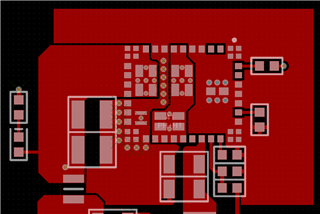

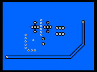

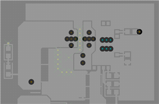

Below are pictures of my layout. Below is not shown how is L6, but in L6 at the chip area there will be a ground fill, similar to L8, bottom, but enlarged.
General view:
L1, Top:
L2 and L5 and L7, Ground planes:
L8, Bottom:
The picture below is shown in the page 23 of the datasheet, I have rotated it 180 to match the orientation of my layout.
The picture above seems to not consider the holes of the picture below, which is shown in the page 34 of the datasheet, which are over the inner pads of PH and VOUT, and that is why my ground planes have more openings.
