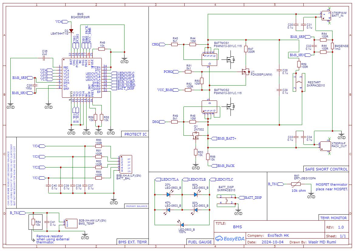

Hello, I have been designing a robot for my final year project. As such, I wanted to use a BMS and selected the BQ4050 based on the reference design of TIDA-00982 (https://www.ti.com/tool/TIDA-00982) and expanded it to a 4s1p design.
However, I cannot seem to be able to wake up the device to make it just turn on the MOSFETs and drive a circuit on the pack side.
I designed a restart button but pressing it does not seem to be doing anything.
I have attached my schematic. Do I need to buy the SMBUS ev2300 communicator to activate the chip or some other ways?
It would help me very much if you can help me troubleshoot on this.
  • Hello Wasir,
    Usually you will need to hold down the "RESTART" button to short between PACK and BAT while communicating to the device.
    Also, I am trying to follow your schematic and want to ask if you have implemented the sense resistor on the high side. This gauge is not able to do high side current sensing and will cause issues.
    Adrian
  • Hello Adrian,
    Thanks for replying back to my issue and thanks for noticing my mistake on the sense resistor. For now, I have just scratched out the traces and rewired them manually.
    As for what you said here:
    Does this mean that the 'RESTART" button just wakes the bq4050 chip to start communicating through the SMBUS to our PC and the BqStudio? But it does not turn on the chip and start functioning, like in Layman's terms, its not a plug an play device, if I am getting this correctly?
    I ned to use the BqStudio to activate the chip and load the chemistry tables before it starts to work and connect the pack and battery side using the MOSFETS, is that correct?
    Shorting the PACK and BAT pin allows there to be a voltage applied on the PACK pin, and this allows the gauge to start communicating with the device. If the gauge doesn't sense voltage on the PACK pin then it is most likely entered sleep or shutdown mode. You will need to short BAT to PACK while communicating to turn on the FETs. After that, you should be able to release the RESTART button and communicate with the device normally. To turn the FETs on, you can use BQStudio and the host MCU to communicate the commands.
    Adrian
