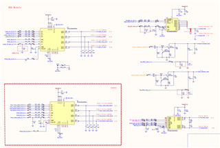

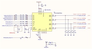

Hi team,
My customer uses TPS4H160BQPWPRQ1 in their project. The TPS4H160BQPWPRQ1 has no output when doing low temperature experiments (-40°C), but it can output normally at normal temperature and high temperature.
Test conditions: Supply 13V, load 1.3A, 4 load drive in low temperature can not output. High side control side has signal, but output side no output.
Could you please help review and give some comments?
Ivy
  • Ivy,
    Nothing sticks out on the schematic- however is this reproducible between multiple devices? If they switch out their current TPS4H160--Q1 with a separate TPS4H160-Q1 do they see the issue?
    Additionally, how are they loading the device? Are they using an actual load or an eLoad?
    Tim

  • Hello Ivy,
    The schematic looks fine and shouldn’t be causing the issue here. In a separate test these devices were evaluated at -40C and had no issues in operation. I recommend using an EVM to verify the performance of a failed chip at your desired temperature.
