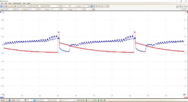

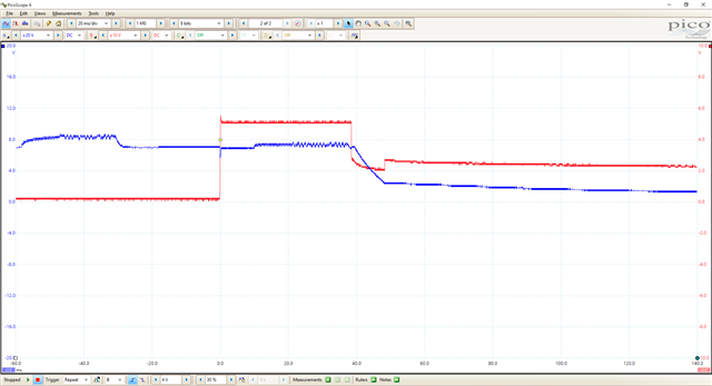

    Thanks for the reply. I am still having issues getting this to work properly. I get voltage on Vrect, and then 5V comes up for about 40msec, and then everything turns off. It repeats this every 1.25sec, which I believe is the transmitter period. I've attached two scope photos that show this. Blue is RECT, Red is OUT.
    I'm using a small coil that I was able to get working using the bq51003EVM, but it won't work on my board with the bq51013B. The coil is ~12uH, and I am tuning with Cs=220nF. Cd=2.1nF. I have a 196 Ohm resistor in parallel with a 0.1uF cap at FOD, and 50 Ohms between FOD and ILIM (1.06A Imax). I started with a 0.5A current limit, but increased it to see if that fixed anything.
    There is a thermistor connected at TS, and is approx 10K in series with 2.6K. AD is grounded. EN1, EN2, and _AD_EN are floating. I've adjusted the OUT load between open and 10 ohms, and the only difference is how fast OUT discharges after shutdown. There is a 10uF cap on the output, which I have also tried removing.
    Perusing other threads, I am assuming the receiver is not communicating with the transmitter, hence the shutdown. I have tried a couple of different COMM values (10n, 22n, 47n) and a couple different Cd values, to no avail.
    Any ideas what I'm missing?
    Steve
