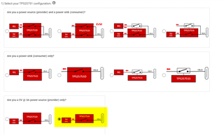

    Unfortunately we do not have a resistor configurable device to meet this requirement. The easiest device to implement this will be the TPS25751. This is a DRP USB PD controller that is configured using our easy configuration tool. In the tool, you would select these 2 main fields and that will basically limit the device to 5V and then always initiate a data role swap to become a UFP.

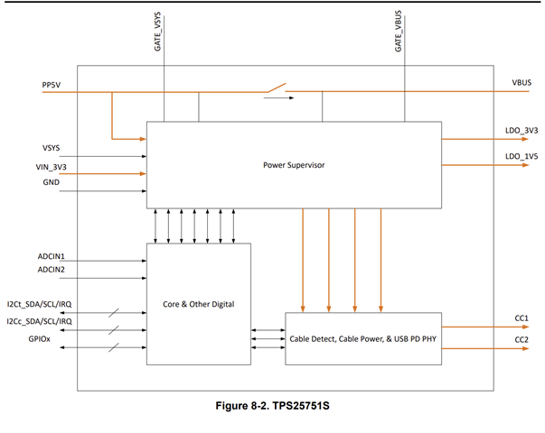

  • Hi Adam, thanks for the information. Since I'm only interested in sourcing power to the upstream data host device, I could use the TPS25751S and not connect any external FET(s) off the gate drive lines (leaving them floating)? I think this is basically what's shown in the bottom right image of the configurator tool you posted?
    It looks like I either need to program this part every time it powers up over I2C, or connect external EEPROM to tell it to switch to a sourcing role at 5V, 1.5A limit. Assuming, since external EEPROM is required, there is only internal volatile, and so no way to get these parts preprogrammed or configured from the line?

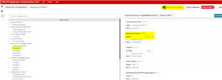

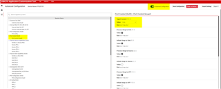

    The options in the configurator only show 5V/3A, but assuming this controller can communicate 1.5A availability with 22k Rp on the CC lines?
    Thank you
  • Since I'm only interested in sourcing power to the upstream data host device, I could use the TPS25751S and not connect any external FET(s) off the gate drive lines (leaving them floating)?
    Yes this is correct and would be my recommendation. That block diagram I highlighted in the above picture is essentially your use case.
    Yes your understanding is correct. The image you generate from the configuration tool will need to be loaded onto the PD controller after every power cycle either through a dedicated EEPROM or an external MCU. Here are two app notes that explain the MCU update or the process of updating the EEPROM image in the field if that is something you require.
    Yes this can be done in the GUI. The questionnaire can help set an initial configuration for the device. You can then enter into the advanced configuration allowing for more control of the device. All of these registers are outlined in the host interface technical reference manual
