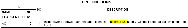

I would like to ask a question on TPS65070.
Pin [AC, 10] is connected to DC input, but why it is called AC? I have found it very misleading since it suggests "Alternating Current" and is the standard acronym for this term.

In this case AC is short for AC Adapter.
