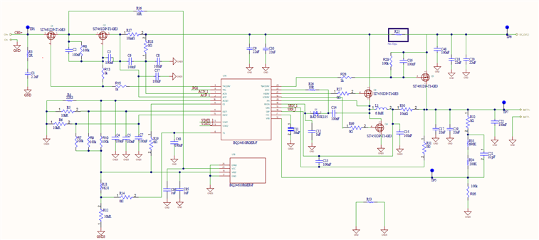

Hello Guy,
Can you provide your schematic?
What is the voltage on ISET1 in both cases?
Christian

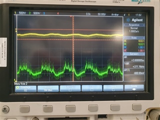

Hello Christian,
I share you the SRP signal with 24V adaptor.
Green colour is SRP signal with C13=100nF
and Yellow color is SRP Signal with C13=400nF.
As you can see we have low noise with C13=400nF, but it's not perfect. Charging current is around 1.3A instead of 1.5A.

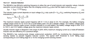

My question is : Do you have an abacus or a formula to calculate the value of L1 inductor ? Perhaps this inductor have an effect depending adaptor voltage ?
Best regards.

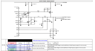

Hello Guy,
Please refer to section 10.2.1.2.1 Inductor Selection in the datasheet for choosting the right inductor:
It may also be beneficial to include these caps in your design to improve current sensing.
Christian.
