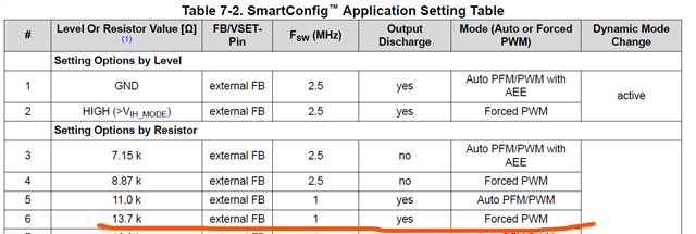

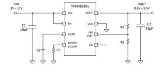

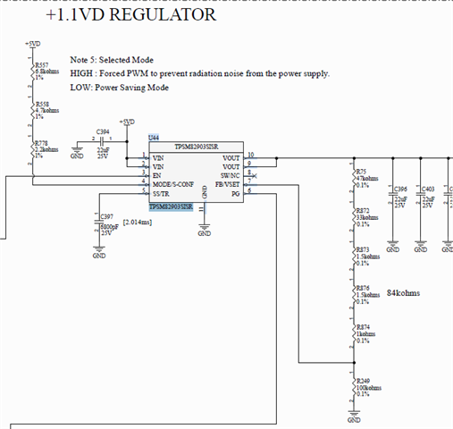

I want to run this IC in forced PWM mode , with Output Enable function. We want output voltage 1.1v fixed.
For this we have selected switching freq Fsw=1MHz. For doing this we connected 13.7k Resistor by pulled up position as per the table 7-2 mentioned in the datasheet.
I want to confirm that is my setting is correct ? or I want to set 13.7K resistor in PULL Down position .
Please confirm this setting on high priority.
