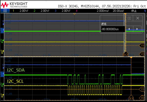

Hello, E2E.
We have been used for years this device(BQ24250).
In recently our production, there are some I2C communication error between our SoC and BQ24250.
No ACK is returned like below wave-form.
I think I2C wave-form is NOT bad, why BQ24250 does not return ACK?
*This wave-form is taken 700ms after insertion Battery or VBUS, VBAT and VIN is already stable.
Best Regards.
