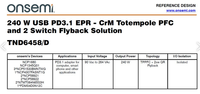

we need a power solution ,240W ,AC-DC flyback
We survey the on solution now as below, may I know the TI if have the same solution? thanks

Hello Alex,
The Onsemi reference design uses the NCP1680, which is a pure analog controller IC. Currently, TI does not offer a pure analog Totem Pole PFC solution. Our existing designs include using the C2000 microcontrollers, or the UCD3138x controllers. The C2000 are DSP-based microcontrollers. The UCD3138x controllers also require firmware but include integrated hardware loops and a GUI for easy configuration.
UCD3138x TTPL PFC Design: https://www.ti.com/tool/PMP20873
C2000 TTPL PFC Designs:
You can search for more TTPL PFC designs in our Reference Design Library: https://www.ti.com/reference-designs/index.html#search?keyword=pfc%20totem%20pole
