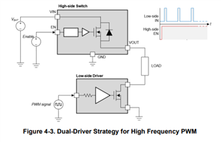

Hi team,
My question is shown in title.
Thanks!
Josh
Hello Josh,
TI HSS are limited to operating at 1-2kHZ PWM frequency. Below is application note on Driving PWM Loads with TI High-Side Switches.
If a higher frequency is required this can be accomplished by reassigning the PWM switching duties from the HSS to a separate low-side switch.
Alan
