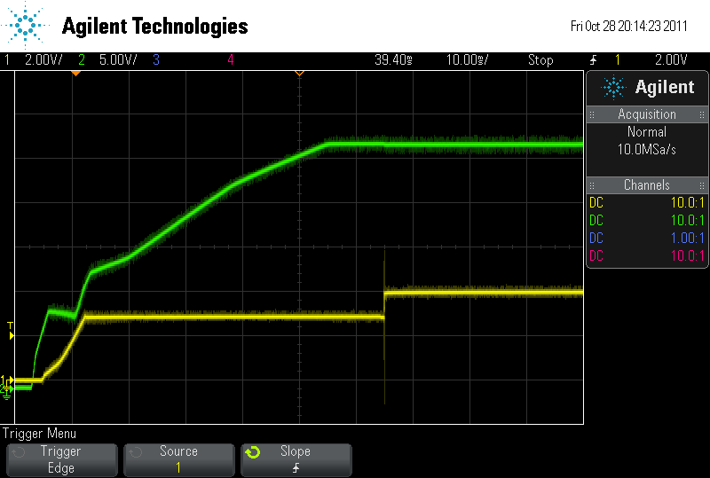

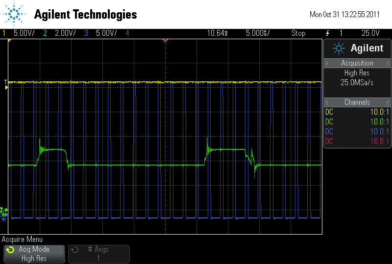

I am using TPS5430DDA in my application. I am observing some oscillation during power up. Below are the input and output parameters of my design. I have attached the waveform captured for reference. What is the reason for the oscillation and how to avoid it. Also one 4.7mF capacitor along with 0.1 Ohm series resistor need to be added in the input for power holdup purpose. Please let me know whether this addition will impact the performance.
Input voltage: 28V
Output voltage: 5.25V
Actual Load: 1.2A
430uF Aluminium capacitor is used at output and compensation network values are C=0.027uF and R=309 Ohm.
