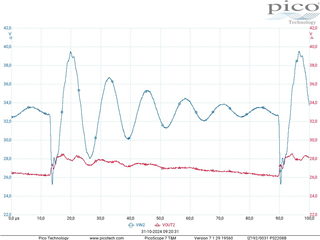

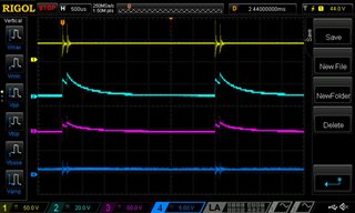

LM74502: LM74502: LM74502 was never really resolved, I see the same issue on the LM74502 evaluation board
Part Number: LM74502
The only difference is that I also see the problem on the LM74502H part:
When recovering from Over voltage protection, the LM74502(H) does not make a clean switch back to on, instead they are unstable until the input voltage is much below the OVF.
I have seen the fault situation with loads from 1 kOhm to 25 Ohm.
