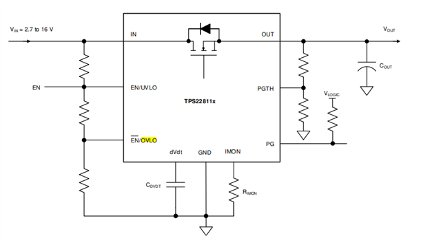

Hi Team,
Can the EN/OVLO pin be shorted to GND if the OVLO isn't used?
Hi Team,
Hi Moon,
Thank you for your patience. There were some holidays hence the delay.
Yes, If OVLO is not required, the pin can be shorted to GND.
