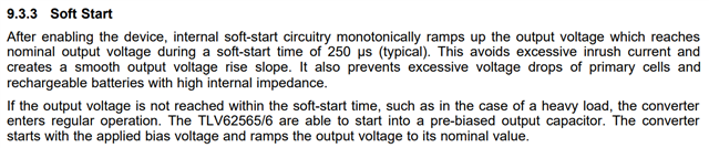

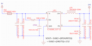

We are using TLV62565  and trying to adjust soft start time using CP42.

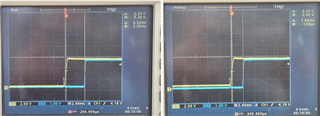

However, the soft start timing changes every time the power is turned on and off as follows:
The first time I measured it, it was 3.32ms, but the second time I measured it, it changed to 1.88ms. This keeps changing every time I turn the power on/off.
Could you please let me know how to solve this issue?
