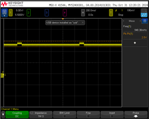

I have a BQ25798 charger connected to my 4S1P LiIon pack. My system works fine on DC in or on battery in, but is giving me constant resets when both are plugged in and the charger is active. We see cleaner operation with the charger disabled. Here is a shot of my schematic:
and VSys looks like this when the charger is active:
