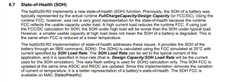

  • Hi Ricky,
    The SOH is calculated using a value known as SOH FCC, which is a FCC calculation based on a simulation at 25degC using the value specified by the SOH Load Rate. More information on this can be found below:
    Based on the fact that this value is calculated from a simulated FCC value and not the FCC value calculated from the external measurements of the gauge, I believe this would be unlikely to have this much variation from EMI. Can you please confirm that the SOH Load Rate is the same in both of these gauges?

  • Hi Ricky,
    Sorry for the confusion, when I stated that it would effect the performance of the gauge, I meant the calculations and tasks the gauge performs based on direct measurements from the system that could be effected by a false current from EMI. Since the SOH is based on a simulated value, I do not believe that the SOH would be directly effected by a false current.

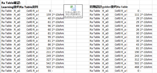

  • Hi Anthony
    Ra Table(Please see the attachment).
  • Hi Ricky,
    Can you please confirm that the RA Tables on the right of this excel are before the test and the tables on the left are after the test? If so, it seems like in the majority of the situations, the cell resistance seems to decrease or stay the same rather than increase.
