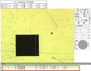

PART# LP5810BYBHR
The physical size is 1.45mmX1.35mm
While on the website datasheet, the size is max 1.40mm & width Max 1.32mm
Have you updated the drawing? Thanks.

Hi Lihua,
Thanks for checking, I think it's a type error.
Please refer the below info:

Hi Lihua,
The process for updating datasheet needs some time, we can't change any information on that manually. We first need to submit a request, then we can change it and at last, we need to get approval, then we can update it to ti.com. So I am sorry that I can't give you the updated datasheet right now.
If you only want to need the package information for this device. Please help to contact me via email (jared-zhou@ti.com). I will send it by email to you.
Thanks for your understanding!
