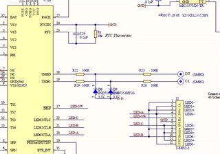

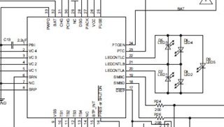

LED lights on BQ40Z50RSMR-R2 was lighting when it shouldn't be
Using 5 leds  -

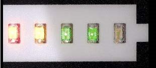

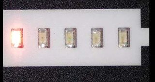

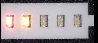

  • leds off  These show LEDs off, 1st Red on Middle Green Dim, 1st 2 LEDs on Middle Green Dim.
  • last led on dim in last 2 pictures. when leds are on dim., they shouldn't be on at all.
  • Hi Ken,
    Thank you for sharing, the configuration of the LEDs within the schematic looks correct. when the LED is becoming dim, can you please confirm whether any current is being received to the dim LED at this time?
    Anthony

  • Hi Anthony,
    I sent the GG file hopefully you can view it.
    We are still working on determining if green LEDs are receiving current.
    Ken
  • Anthony,
    Also, is there a way you could do a conference call with us and our end customer on this issue?
    Please let me know
    Thanks, Ken
  • Hi Ken,
    Understood, please confirm whether there is current being received at the dim LED.
    It is possible to have a conference call, however I would like to get more information before this. If possible, can you please share a .log file of the gauge when this dimming situation is occurring?
    Also, if you could share a layout image of the LED routing from the device we can check this as well.
    Anthony

  • hi Anthony I added the log you requested. I don't have any current measurements yet. What else do you need? Thanks for your help.
  • Hi Ken,
    Thank you for sharing. In the log file I see that RSOC is 35% where LED 1 and 2 should be on, but there is the dimming from LED3. Along with the current at this time, can you please tell us what is being seen from the LEDCTRLC pin? If this is being pulled low while LEDCTRLB is outputting a high to turn on LED2, we could have a better idea of what is going on here.
    Also, I see that bq40z50-R2 is being used here. We recommend that the latest firmware is used which is the V5.04 version found below:
