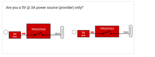

When we were doing PD compliance tests, we encountered issues related to VCONN swap. Our device will still send a VCONN_Swap message when the test plan expects VCONN_Swap_To_On_Supported = No.
We would like to know if USBCPD ACT still allows setting the VCONN_SWAP field? If allowed, how should we set it? If not, what should we do?
    Thank you for reaching out!
    VCONN swaps are enabled by default in source-only, and DRP configurations. For sink-only, VCONN swaps are disabled.
    In the VIF, the VCONN swap fields should be set to "YES" if you selected any one of the following configurations:
    Please let me know if you have additional questions/concerns.
