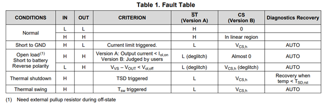

We are planning to use the TPS1H100BQPWPRQ1 to switch a variable load that ranges between 5mA and 2A, with the load always connected (in fact the load in this case is the BLDC driver DRV10983SQPWPRQ1 also from TI). I am concerned that, due to the open load protection feature, the switch might detect the standby current of the load as an open load and cut power to it.
Is there a way to disable the open load protection to prevent this from happening? Alternatively, would adding a fixed 30mA load at the output help solve this issue?
