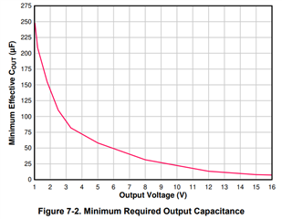

TPSM560R6H: Required minimum output capacitance for load current of 60mA
Part Number: TPSM560R6H
Hi
Hope you are having a great day !
As per the datasheet , we need to place at least  22uF to 25uF for 10V output voltage. We have a constraint on the board space and cannot accommodate more capacitors.
Can you please suggest us the minimum output capacitance we can go which does not impact stability , transient response and other parameters ?
Also if you have any ESR requirement for the capacitors , please let us know.
