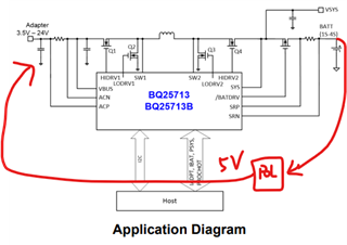

My customer currently design in their project will have a mode, let the battery input to a POL then output 5V for system used, but they currently connect this 5V back to the input side of our charger.
And at this moment the charger register was been set/read as below, we saw the charger is under IINDPM mode.
I think the system 5V source back to the charger's input should be not correct, now IINDPM mode was also an issue in their system, that is why I'm asking a way to disable entire BQ25713 under this condition, is it possible? May pull low a HW pin or set any register bit ?
Or how can we config it so let the charger not in IINDPM mode ?
