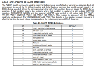

Hi Team

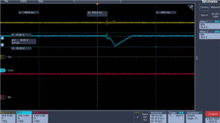

my customer meet a voltage drop issue as below.
could LM5066I record fault event after it recovery?
because they happen this issue in 100ms. I think if we can't read the event on time. we won't know what is truly issue.
