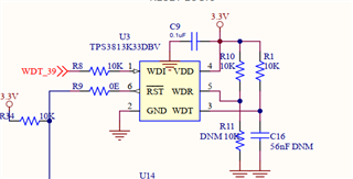

Dear Team,
We are using TPS3813 ic as external watch dog for my microcontroller, and its working fine as per expectation,
it reset the MCU if my system working fine(In testing put a while(1); in firmware and its resset by TPS3813 ),
but we found if MCU goes Hang (stuck some where) TPS3813 also goes Hang mean it not reset my MCU, now I'm how its possible that TPS3813 ic didn't work.
as per attached schematic pin 6 RST connected with MCU reset. we observe this strange behavior on oscilloscope also.
Please suggest what wrong with circuit what else we can try to over cum this type of problem
