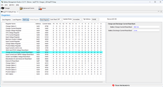

We are charging 1S battery via 5V/2A adapter, it's charging very well and current is 0.5A on the cable. however when we measure IBAT and IADPT, it returns 0x00.
CHRG_OK is high
ChargeOption_1 [15] (EN_IBAT) = 1
ChargeOption_2 [6] (IBAT_SEL) = 1
ADC_Option [2] (EN_ADC_ICHG) = 1
ADC_Option [14] (ADC_START) = 1
RSR = 10mΩ and set ChargeOption_1[10] = 0
RAC = 10mΩ and set ChargeOption_1[11] = 0
I've measured IBAT/IADPT pin via oscilloscope;
When POR, IBAT -> Vmax: 0.40V, Vave: 0.1V
After continuous -> 0.1V or 0.0V
Circuit are as EVM spec.
Is there any advice about that?
