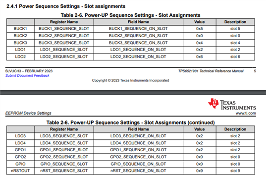

Our customer use TPS6521901 with setting that BUCK2 is not used.
In datasheet, LX_B2 connection if not used is leave floating.
Does we need change power up sequence too? In TRM of TPS6521901, the default setting of BUCK2 start up sequence is start up first after ON-request.
TRM : https://www.ti.com/lit/ug/slvuch3/slvuch3.pdf?ts=1731292385380
If don't change the setting of sequence, is it possible that this cause other output cant start up?
teritama
  • Hi Teritama,
    The sequence waits for each rail to be stable before enabling the next rail. If the components are populated on the BUCK2 output, then it should power up okay. Or BUCK2 would need to be disabled in the EEPROM settings.

  • Hi Matt-san,
    Thank you for reply. I understand if not use BUCK2. we need to set EEPROM to be disable or component(L and C) mount on LX_B2.
