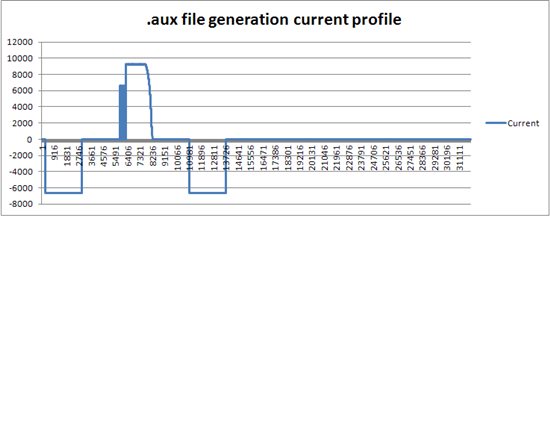

Dear all:
          I have use BQ78PL114 EVM according to slua505b.pdf generate the data log file (.csv).I import the data log file (.csv) in the Aux Chem File Utility generate Aux,but the Utility have the following tips:
Please help me Solve this problem.and I need a CSV templates.
Thanks a lot.
John xiao
2011.11.1
  • Dear all:
           Attach tip:
    Opening input .csv file : C:\Program Files\Texas Instruments\bqWizard 3\Data Logging Files\6cell.csv
    Checking log file headers : missing the following field (s) SB_V1 SB_V2 SB_V3 SB_V4 SB_V5 SB_V6 T1 T2 T3 T4 T5 T6 Passed
    Check log file for correctness - Check TI SUpport for further information
    Since 'Passed' is missing, this file may not have been generated using the correct .dlog file
     John xiao
     2011.11.1
  • Hi John,
    Page 8 of SLUA505b details the data collection procedure for the AUX File.
    Section 4.2 Data Collection Procedure
    What version of bqWizard are you using?
    Also could you attach a copy of your AUX file(6cell.csv) data here so that we can review?
    Ben
  • 4718.4S.zipHi Ben:
         The Version of  bqWizard is 3.1.
         I also use BQ78PL114 EVM according to slua505b.pdf generate the data log file (.csv).import the data log file (.csv) in the Aux Chem File Utility generate Aux,but still failure.4S.CSV such as attachments.
  • Hi John,
    I see you created your dlog file..it is advisable to use the dlog file as suggested in slua505b.
    Also, a plot of your aux file generatiion current profile does not follow the recommended process.
    The expected profile is;
    Ben
